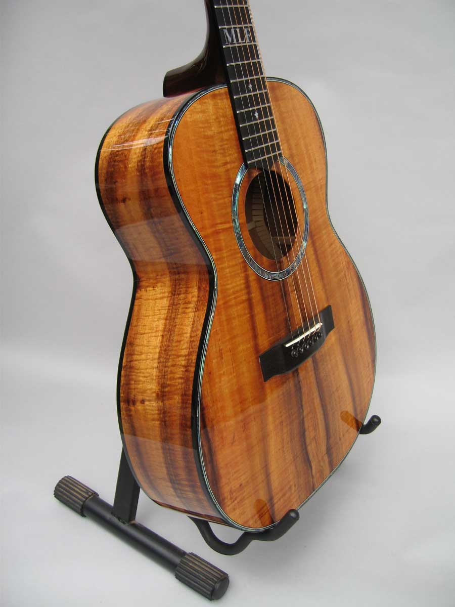

I have built one and now on a 2nd all Koa guitar. They are nice if you want a
dark top.
